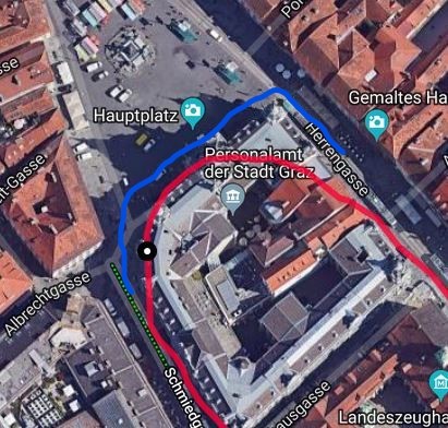

    typical problem: Garmin seems to clairvoyant abilities. The following blue line in the picture was the path within the fences at the race! The red line was recorded by Garmin fenix 6x sapphire! Garmin always cuts the corners. With my Polar V800 it mostly overestimates at changes of direction, but corrects very soon. It is impossible that the Garmin-device knows where I am going to run before. That means Garmin interpolates because of bad accuracy after determining the locations and records some seconds later.
