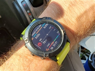

Interesting... so the black spot goes away when you remove it from the sunlight for a while?
I'd say, if it bothers you then I'd exchange it for another one.
Put off your screen protector. This may help.
This is the first report I've seen of a dark spot on the screen (there have been some reports of darkly-lit spots with the backlkight on, but I think that's different, because your dark spot appears without the backlight illuminated).
It would probably bother me enough to send it back for a replacement.
Keep in mind that this solar display thing is brand new technology, as far as I know this is the first watch ever to use it, and it's definitely the first Garmin to use it. So there are bound to be some issues with some of them. I think this watch is a good candidate for a replacement.

Is it a solar panel behind an LCD screen?
If you were charging the watch in the sun off your wrist, then likely the display got too hot. Dark spots like the one you show are typical on other solar powered watches that are left in the sun and get too hot. Charging while on your wrist prevents the watch from getting too hot. As long as you charge the watch in the sun by itself, even an exchanged watch will likely exhibit the same issue. Always charge in the sun while wearing the watch to prevent this overheating of the watch. Unless severely overheated, the watch should return to normal when it cools down.

If the watch get to hot, the solar charging is stopped automatically and a red thermometer sign is displayed on the display. Have done several solar chargings with laying the watch in direct sunlight for testing the solar functionality, but never saw a black spot on the display.

Understood. I wasn't sure whether you were wearing the watch while charging. If your display is darkening while you are wearing it, I would consider that cause for concern. I don't know if that would be the case for all 6x PRO Solar watches, but if it were me, I'd strongly consider swapping your watch for another one - couldn't hurt. Good luck.

My 6x does the same
