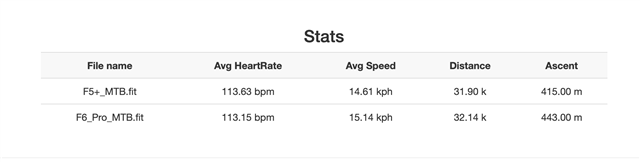

  • This from a MTB ride on Sunday. I really can't get too concerned at a difference of 240m over 31km? One watch on either wrist.
    And my wife recorded this on her 945...
