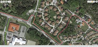

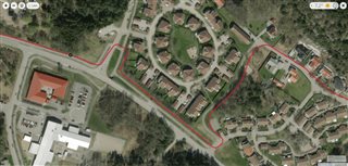

  • The past weekend I did a trail run that was ≈27km. My watch was almost spot on with the distance signs along the run. In the end my watch said 26.41 and I think that is more correct than 27... One thing that is important to me is that it is consistent, something that my F3 always was. I haven't done enough runs with my F6 to say it is consistent but so far I don't see any issues with the distance.
    https://connect.garmin.com/modern/activity/4081333616
    I'm not a pace runner, I rely on HR during a run.

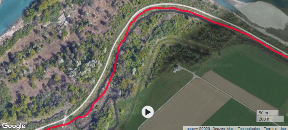

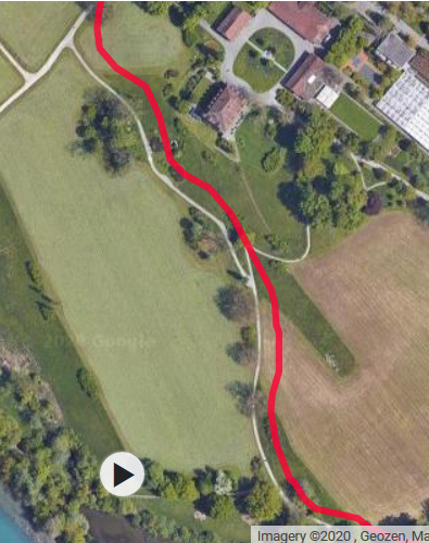

  • I just posted this to a similar Reddit thread but thought it could be good over here too. I’ve got three runs at this point that all on the watch were short.
    One was a week or so ago, five miles that I followed a course I created and ported over via EasyRoute. I was also following a structured workout at the time. At one point on the course the route I drew wasn’t available and I had to deviate. It was a deviation that added distance not subtracted because I had to go around. Plus I ran probably a .25+ mile before I realized I was off and had to backtrack, etc, etc. Well towards the end of the loop which according to the drawn route would have been over five miles many watch was showing like 4.65. I finished the loop and even made it back to my car and it didn’t tick over 4.89. I thought it had something to do with the structured workout with the course following but I’m not quite sure.
    The other thing that was odd with the 5 mile run is when I pull up the GPS track on Garmin Connect their own mile markers show the run was over five miles.
    I did an 8 mile run this past Saturday following a route built on EasyRoute and ported over but no structured workout this time. Same thing happened here. The route should have ended about a quarter mile past my start point but it was well under that when I finished.
    Same similar results with a five mile run I did yesterday. Looking back at the drawn course for the 8 and 5 miler the watch mile markers seem to be like an 1/8th of a mile past where the drawn map is.
    I did have one run that was 3 miles that hit the mile markers for a drawn course dead on, so it may be something with longer runs.
    I always set to 1 sec recording and GPS+Glonass when I get a new watch. I did double check that before this last five miler and it was set correctly.
    Additionally I looked back at the actual gps tracks, they’re nearly spot on. On the last run the watch even perfectly nailed a 170 degree turn. Very rarely is the gps track off the route I was on and even when it is it’s maybe a meter or two at best.
    I have a feeling it’s the algorithm on the watch is calculating the distance between points incorrectly but I don’t know enough about that math to prove it.
    I reached out to support and they told me how to adjust my gps settings (real helpful). I’ve got a shorter run tomorrow but I’ll see how it compares. I have a longer run this weekend that I might go full DCRainmaker and run with three watches. I’ll have two follow a course and one not then compare the results.
