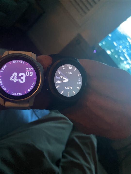

I bought two fenix 6’s today, both are the Carbon grey DLC coated with sapphire glass.
Have a look at these photos, my wife's is on the left hand side and mine the right. Her looks very yellow compared to mine which looks far crisper and sharper. Both have backlight set to 50%.
Any thoughts on if there’s a setting other than backlight that could cause this before I go back to the shop where I bought them?
  • Thanks a lot for getting back to me so quickly.
    So you would say that the slight red tint is okay? The blacks definitely look pretty deep too me.
    Thanks!
  • Ok, feeling relieved. Thanks for your feedback.

    It is hard to tell from the pictures in the night. Make photos with about 30,50,100% backlight during the day, but not too much light. I posted a pic here, 6 months ago, during the day in comparison with a blue screen watch and difference was night and day, and I think it was 100% brightness and it looked 100% black then. During the night all display have a little washed out color. That is the type of display they use.
  • During the night all display have a little washed out color. That is the type of display they use.
  • Well, I've noticed it really depends on the camera that was used to take the photos of your screen. Therefore, it's quite difficult to tell you if your particular unit is a "bad" one or not. I did a simple test by taking photos of my Fenix 6 Saphire by using different modes on my OnePlus 7 Pro phone and see the results below with backlight at 30%:
    • standard auto-mode with the flash turned off -> pretty blueish
    • standard auto-mode with the flash turned on -> pretty black
    • night mode without flash -> acceptable black
    However, in reality, I swear the black is black on my Fenix 6 Saphire, regardless you set the backlight to 10% or 100%. Hence, I'd be careful when telling someone that his watch unit is bad and subject to replacement just based on the taken photo. As you see, your watch might look like the one with the worst possible blue tint and with the perfect black at the same time...
    See the pictures here and make your own decision ;-)
