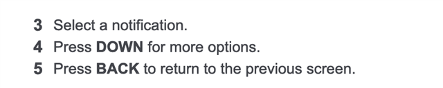

    I think it's def a bug.At list from the way it looks from the manual.

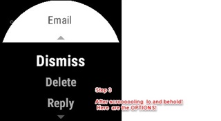

  • My major complaint is that the smartphone notification interaction on the 6 is different than any other interaction on the watch.  The default of pushing Down performs a permanent action.  No place else does this happen -- Down is normally used to scroll through information.
    Not only that, but if you click Down, then it dismisses the notification on the phone! This can be really annoying if you don't happen to notice which app the notification came from you could spend a minute or more looking through email, slack, flowdock, skype, facebook, etc. to find it.

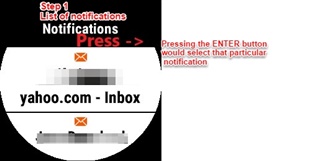

    I have wrote to Garmin support and they wanted me to be more clear about this issue. So I did some screen shots and sent them to support.
    I will post em here as well if any of you want to write to support.

    To others in this thread, looks like 9.0.0 fixed the issue I described. They moved Archive back up to the top and not to the bottom. I am happy they restored Fenix 5 functionality! Not sure why they removed it to begin with up until now though.
