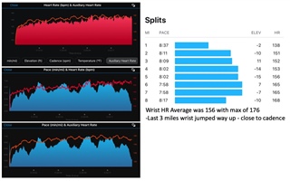

  • Here is what I found - Spikes are often and seem to be picking up my stride rate - I have shaved a spot on my arm and am wearing the watch much tighter.  See image - shows pace and HR -with OHR and other view with HR Strap.  Also has comparison between the two HR lines.  I also included my Strava splits - relatively steady pace with much higher HR average in the last few splits from the OHR.
