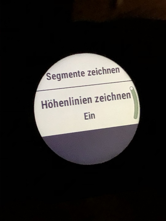

Activity >maps>draw contour lines (disabled it)
I do have a switch to toggle contour lines on and off
e.g. Start activity Trailrun > Trailrun Settings > Maps > „Use system Settings“ OFF > scroll down to last option
