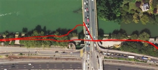

I've been pretty impressed buy the GPS accuracy of the Epix, even without multi-band, as good or better than the Forerunner 55, but I had some bugs today in multi-band mode, both after going under a short bridge and probably losing the fix.
The first time pace picked up abnormally, from 5/km to 4'30/km as seen below

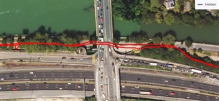

and the track when completely off course (the second one is on the way back)
Has anyone else noticed these ?

  • Would be interesting, if this also will happen with using “gps only” setting? Perhaps the multi gnss mix is somehow confused by the underpass?
  • It's always best to change only one parameter so I'll rerun that route with multi-GNSS but without multi-band to see if I have the same problem.

  • So I redid the test today with multiband off (still with Multi-GNSS) and no problem this time where the track was off yesterday and I didn't notice any obvious pace problems after the other bridge. This is of course anecdotal but still it happened once so it's bound to happen again and you'll never know when...
