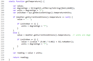

Weather.getCurrentConditions().attribute crashes when data is not available SDK 3.2.1
I am using the brand new shiny SDK 3.2.1 weather feature which I absolutely love. However, I was dismayed when my watch face crashed in the simulator after I unchecked the "Weather Data Available" box in the settings. I was calling Weather.getCurrentConditions().temperature, and I got an unexpected type value error. When I called Weather.getCurrentConditions() instead, it recognized it as a null value and I could use an if statement to work around it. I have not tested the other weather functions or attributes.
Can the attributes for the weather functions get null values when data is not available? Thanks

  • "although I am not following your use of makeTemp."
    makeTemp is just a helper function that does things like C to F conversion.
  • The documentation for Weather.getCurrentConditions() explicitly says that it may return null if no data is available. The API is behaving as advertised, the issue is with your code.
    This is your code from line 211:
    if (Weather.getCurrentConditions().temperature == null) {
    The problem is that Weather.getCurrentConditions() can return null. If it does, your code evaluates to this...
    if (null.temperature == null) {
    The null value doesn't have any member data (no temperature field), so you can expect that to produce an error, which it does.
    If you want to do this correctly (and efficiently), you want to check for null in places where it is possible and avoid multiple calls to getCurrentConditions. Something like this:

  • Former Member
    Former Member over 4 years ago in reply to jim_m_58
    Hi Jim,
    Thanks for the tip. I have this function in a separate Util.mc file, but in this case the strings are so simple I can just use "C" and "F" instead of calling resources.
    Since temperature is the only thing I need, at first I did not even think about using the broader function Weather.getCurrentConditions() by itself. But after reading the API and seeing that it should return null, I decided to try it.
    This is the error I get in the console:
    Error: Unexpected Type Error
    Details: Failed invoking <symbol>
    Stack:
    - getTemperature() at C:\...\source\Util.mc:211 0x1000071d
    After I this code:
    The line reference is the same line as the if statement.

    You shouldn't need to null check Weather.getCurrentConditions().temperature
    What is the error you see, and which line is referenced?
