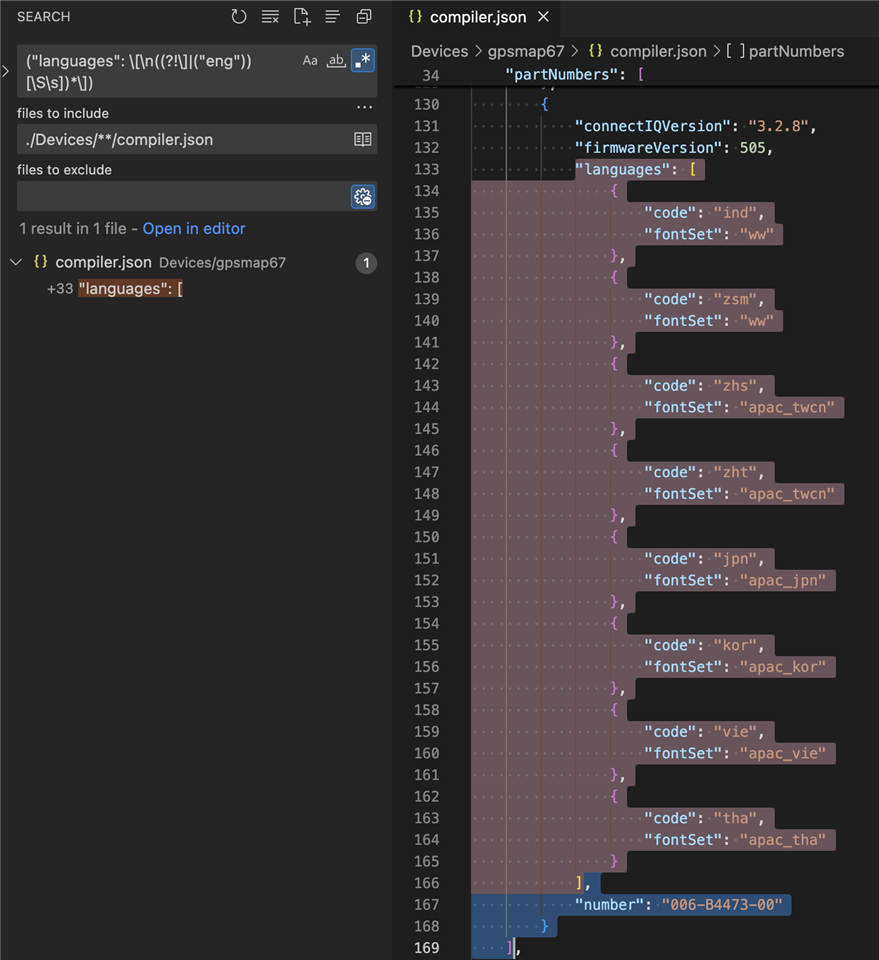

  • Here's regexp you can use to find any language array (aka part number) which doesn't support English:
    I tested this in VS Code.
    Here's a similar regex to find all language arrays:
    Regexes in text form available here:
    https://pastebin.com/4v4RJ7qC
  • > I won't waste time to check jsons and language, simple I will check all languages, make default resources and because compiler uses tree to build resources it will use default strings for any language I will dicide to not translate...
    I don't think you have to do that. Just do what you do today -- select the languages that have non-default resources -- and also add English to the list.
    I did a quick check and out of 298 part numbers, only one of them doesn't support English: gpsmap67 (APAC)
