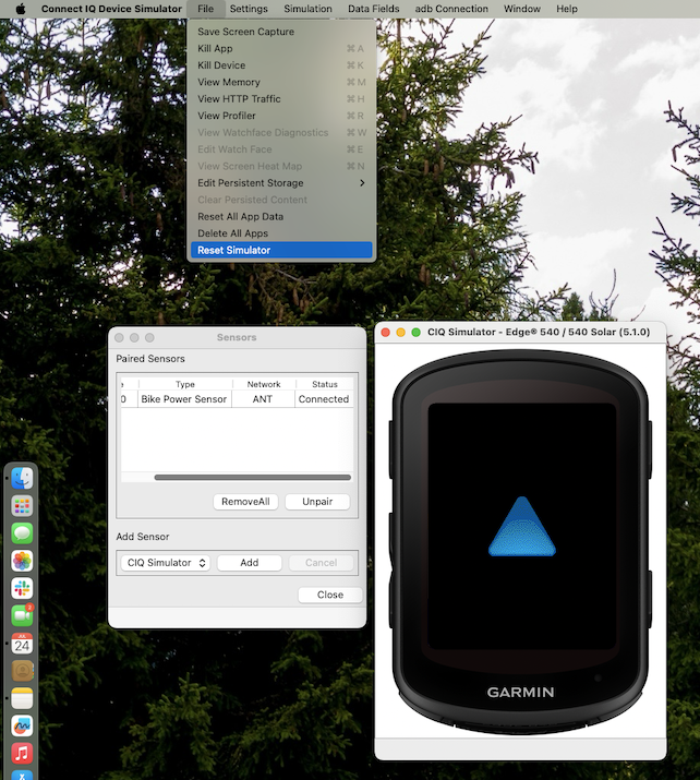

    > the button to "Reset Simulator" seems to do nothing
    Seems like it deletes ConnectIQ/simulator.ini which contains things like the last window size and position, without closing or restarting the sim itself. I'm not sure if this has any real effect, because as soon as you close the sim, it recreates simulator.ini anyway (and not with defaults).
    Also, if you select the menu item 2 times in a row, it complains that simulator.ini doesn't exist.
    Seems like it would be better to just get rid of that menu item.

    First, in the ConnectIQ Device Simulator nav bar File menu, there's no way to "Restart App" and the button to "Reset Simulator" seems to do nothing.

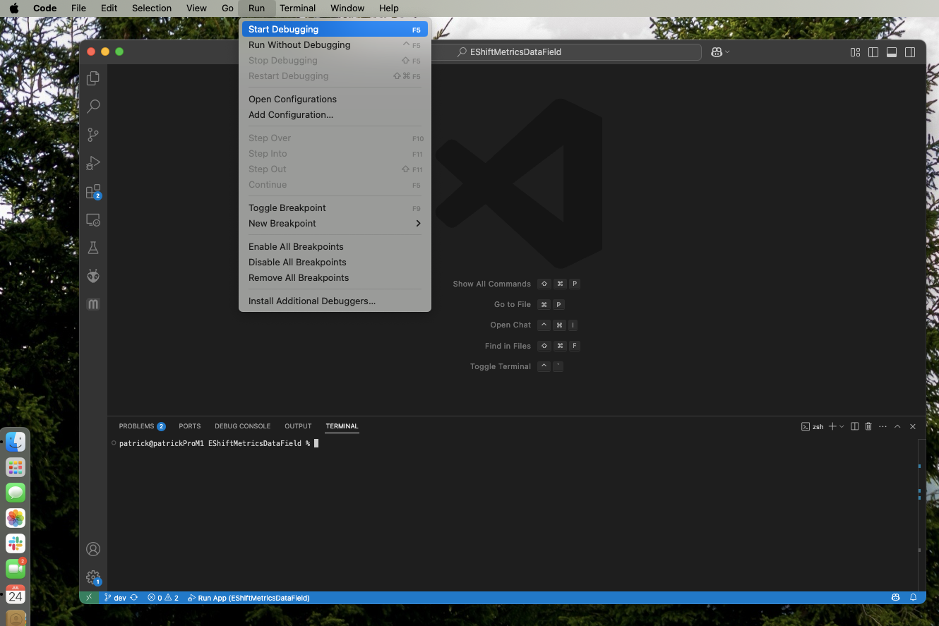

    Second, like you said, if go to the VS code nav bar Run menu, (without first closing the simulator, so I still have the simulator open), and then if click "Start Debugging" or "Run without Debugging" these sometimes don't work. Now that I know the trick i'll just keep clicking those until the app actually reboots in the simulator without closing the simulator.
