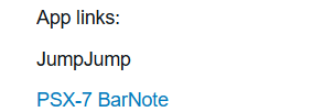

  • To be clear, in my original comment I also had a link to jumpjump, with the link text "JumpJump" and the forum removed that link as well (converting it back to plain text).
    I guess the forum just doesn't like that link for some reason.
