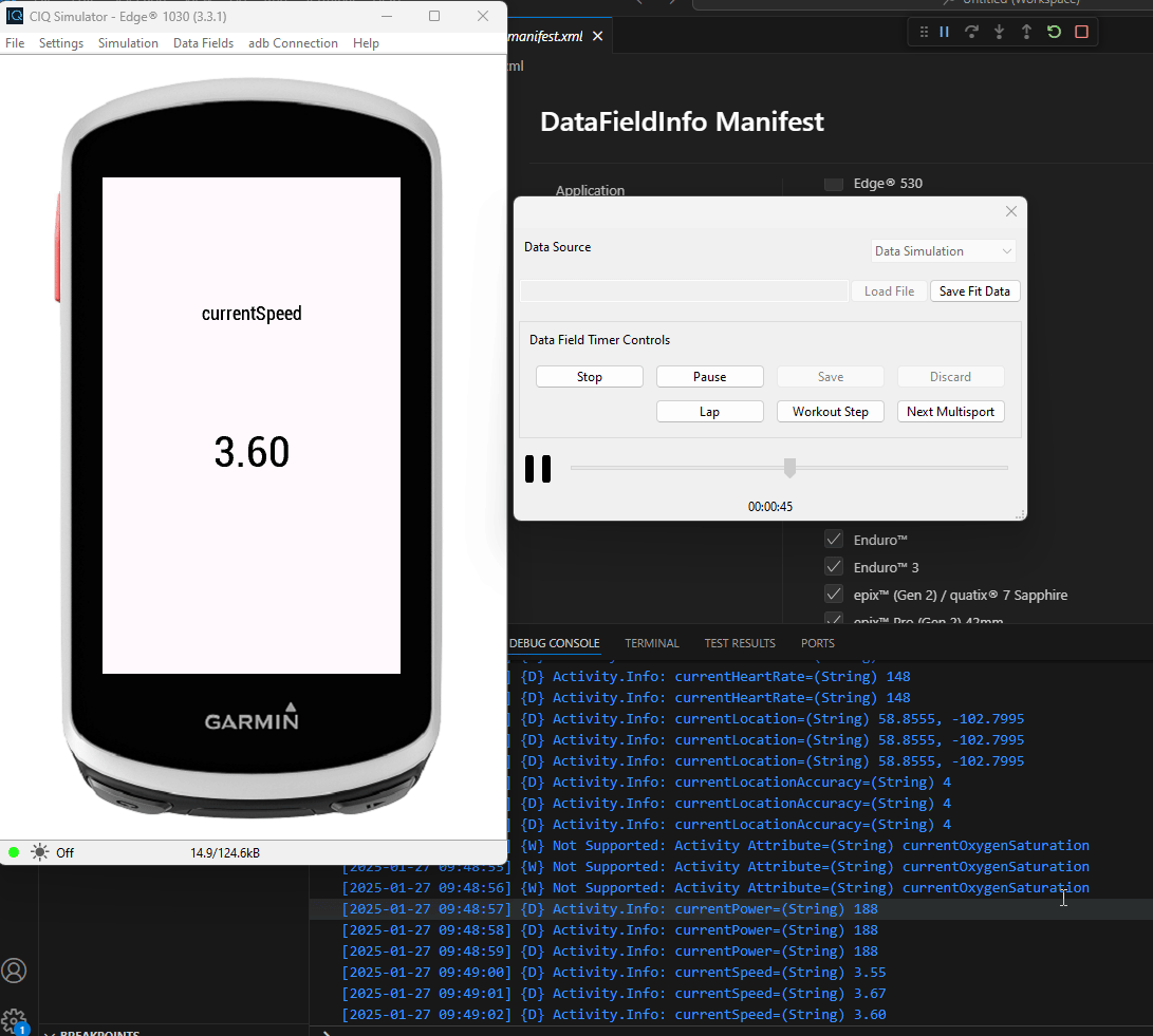

    Here are my results:
  • I agree that the UI for Simulation > Activity Data is a little confusing (and was even worse in the past), but I think the buttons in the data field timer controls are supposed to do exactly as described: Start, (Auto) Pause / Resume, Stop, Save, Discard, (take) Lap, (end) Workout Step, (advance to) Next Multisport (leg). More to the point, most of them correspond with various CIQ data field event handler functions. So if there's any confusion or inconsistency with the buttons in the sim, the same would have to be said of the corresponding event handler functions, I think.

    - The Play/Pause button is for starting/stopping FIT file playback or simulation
    I think the biggest problem with this UI is that it's possible to click Save Fit Data before you've clicked Save in the timer controls. When you do this, the simulator will dutifully save a corrupt FIT file that can't be opened by monkeygraph (for example). The same problem has existed since the beginning, and there were definitely posts in the forums from people wondering why they couldn't use the FIT file that was saved by the sim.
    Idk, in general it fits with Garmin's rep for not being the strongest at UI/UX. One could argue that it's confusing for the FIT playback control and the timer controls to even be on the same on the same dialog. (Then again, I can understand why they are on the same dialog.)
