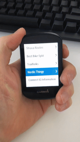

    This seems pretty consistent on the edge for me at least:
    So that is running a modified Nordic thingy app, I also did a version based on your Pi project with similar behaviour. It's especially bad with it running as a widget that automatically starts scanning, then the widget loop crashes easily.
