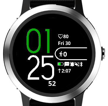

This watchface was created by request and is meant to mimic the stock Forerunner 645 watchface.
Screenshots:
Currently the features are...
Customizable:
- Foreground, background and main tint
- Show seconds in 1hz mode (if user chooses to)
- Customizable userfields (1 main field, 2 extra fields)
- Battery as icon or percentage text
- System icons can be shown or hidden (bluetooth, nodisturb, notifications, etc)
Values available for the customizable user fields:
- Steps
- Calories
- Distance
- Sunset/Sunrise (or automatically show whichever one is first)
- Heartrate (buggy?)
Still in development and open to suggestions and requests :)

  • for some reason when setting sunrise/sunset as an option in the main data field, it stays blank. I thought it might be due to not having synced GPS in a bit, so i started GPS, got a lock and it was still showing as blank.
  • Thanks for the feedback!
    I just released a version where a bug with sunrise/sunset (specifically the combo... not sure if you are talking about that or also when selecting just sunrise or sunset? Then I'd have to look a bit further.
    Which watch is this on?
  • Fenix 5x, and yes, the combo field is the one that is blank.
    Thank you

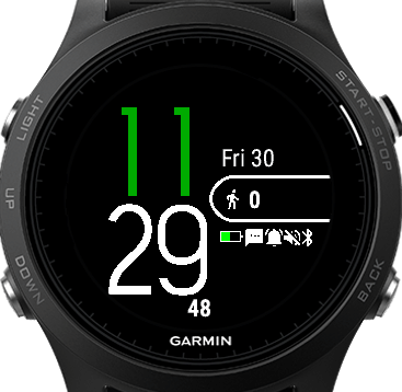

  • Thanks for doing this. I love the 645 face. A couple suggestions:
    (1) By default the 645 showed the *weekly* distance in the round box. Yours seems to show daily distance. Can you add weekly distance?
    (2) I think the seconds are on the 645 were right justified w/ the time numbers ... you appear to have them centered. I would prefer right justified. Take a look and see what you think.
    (3) The numbers fonts still look a little chunkier to me. Also, Garmin some how was able to get better smoothness on their curves.
    Thanks again,
    -Greg
  • Looking at the font though it looks pretty close in thickness and unless I look closely look pretty smooth.
    The only other thing is the runner icon doesn't look quite right. I'm not sure if this is a stock image or one you have had to make. I didn't notice until I started over analysing the whole thing.
  • Thanks for the feedback people...
    e
    Not sure if I want to spend the time to make a real 1:1 copy to be honest. Wanted to get a pretty even match but don't have the time (or knowhow) to create my own icons and fonts and all. (So yeah, these are ones I found through google searching for good matches).
    The seconds are right aligned if I am not wrong, seems to be as the FR645 face. I can see if I can find better icons and improve it a bit more of course (also with regarding to the fonts... THe ones for the hour/minutes is a custom font, the icons are a custom font, the rest are just system fonts (also wrt memory and efficiency).
    Anywayay, I'll look at the suggestions and see if I can implement some of them. Won't be the coming days though as I am away for the weekend ;)
  • To be honest if it stays as is I am very happy with it. I don't know what it is about this watch face but it just looks cool.
