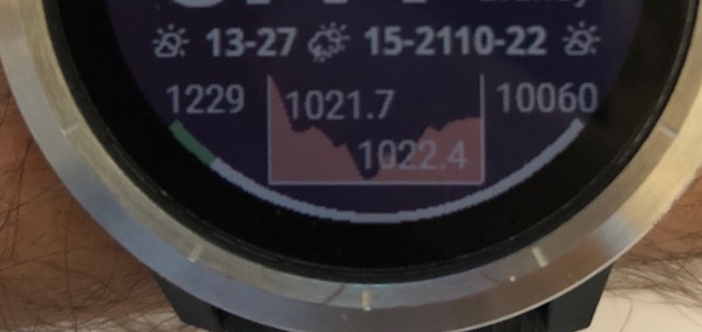

    Here is a picture of the watch face on my Garmin Fenix 5X Plus. As you can see, "C" for the temperature is cut off at the edge.
    Other request is that is it possible to get the current location of the weather from GPS instead of manually put it.
    community.garmin.com/.../1391398.jpg
  • I'm aware that when the time has 2 digits that the °C is shown slightly cut off, but when putting the temperature closer to the time then the time is not as readable any more.
    The watch face already picks up the gps location from your latest gps activity (eg a "run" activity).
