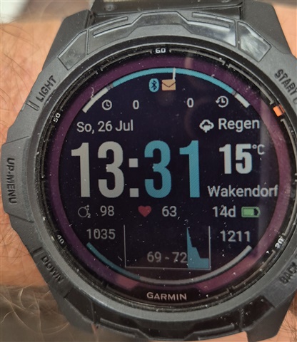

  • I love the watchface very match have 2 suggestions can you add wind direction in weather please ?
    Can you make a barometer chart as an aditional option to heart rate
    Thank you !
    I love yours jobs !
    Pavel
  • Thanks Pavel :)
    barometric pressure chart was already on the to do, I've added the wind direction suggestion on my to do.

  • Hello,
    This is a great app! Thank you for taking the time doing this. I love everything about this except the weather refresh rate. I filled in the donate key and it seems that the weather still not refresh every 15 mins. It stucks at 1 temp for several hour. My suggestion is can you can poll weather data from the weather app on garmin (the default app of the watch) instead of depending on yahoo?
    Thanks
