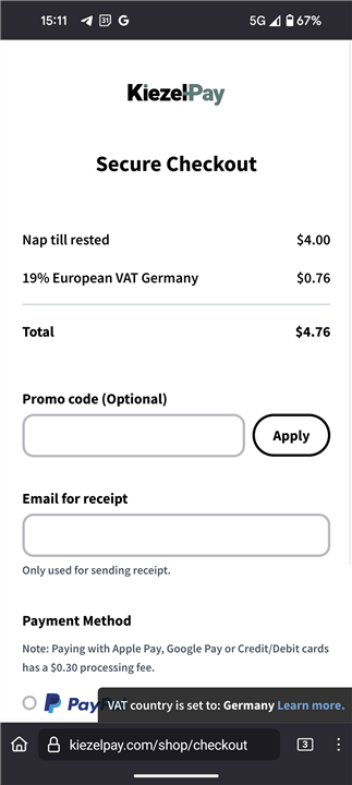

This is also a learning place for me to learn about payment options, so I've implemented payments with kiezelpay.com. I will write about that in a separate post in the developer discussion forum.

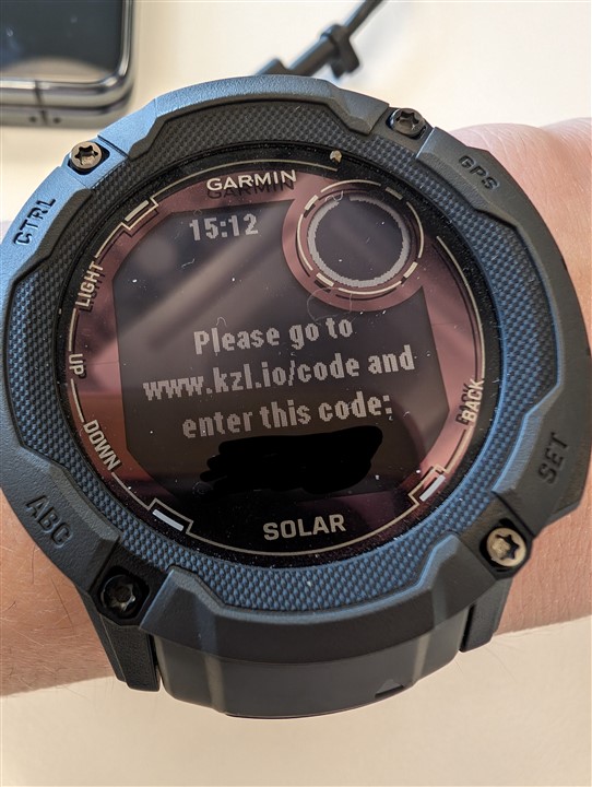

    Also a menu option is shown, to allow the user to purchase the app. If will only be shown after the watch managed to contact the kiezelpay server and to check the license status.

    However, I can't really try it without buying, because after download and playing around with it a bit I pressed purchase just to see how it works and since that it doesn't let me start, always just show the purchase screen. I happily donate, but it's still a bug to fix.
