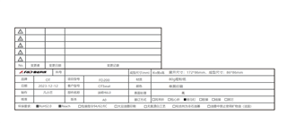

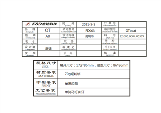

  • TL;DR it looks like an earlier hardware revision / internal model [2021] of the OTBeat Burn supports both ANT+ and BLE, while a later revision [2023] only supports BLE.
    If a sensor broadcasts either via BT or ANT or both, it can connect to the watch. However the DataField only connects to ANT sensors.
    Yeah.
    I originally thought the post you were replying was only talking about general connectivity (and not this app), but I think I was wrong about that. If you search google for "otbeat burn fr165 music", there's a post on a different platform which asks the same thing in slightly different words (I assume it's the same person), and I originally thought it was only asking about general connectivity, but now I see it says "ant+ app". Sorry for the noise.
    Btw I found *another* source for the OTBeat Burn manual (a 3rd party site) which says that it supports ANT+/BLE (Bluetooth 5.0).
    https://manuals.plus/otbeat/burn-heart-rate-monitor-manual
    ^ this page has a link to an archived PDF version of the manual (presumably originally downloaded from the official orangetheory.com site):
    https://manuals.plus/m/a1a95198f2a8f73390ed7bab3d2a5e78f67e879bb584368089c810fd0ab654ab_optim.pdf
    On the last page, there is a date of 2021-05-05 and a "company model" of FD063.
    As mentioned above, the current manual on orangetheory.com (https://www.orangetheory.com/files/otbeat/user-guide.pdf) does not mention ANT+, only BLE (Bluetooth 5.1).
    On the last page of this manual, the date is 2023-12-12, and the company model is FD200.
    Pretty much everything else about the two manuals is identical.
    So it looks like there are at least 2 internal models, and the later model dropped support for ANT+, while upgrading the supported Bluetooth version from 5.0 to 5.1.
    4010091 probably has the later model which lacks ANT+ support.
