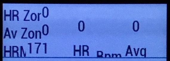

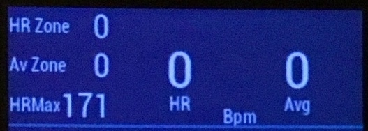

I'm not sure if this is expected or not, but there seems to be a difference between Gfx.FONT_xxxx and Gfx.FONT_SYSTEM_xxxx on Edge 1030 devices. I don't see the issue on Edge520 and Edge1000. Basically, the System fonts on the 1030 appear to have a larger "XTINY" font compared to the .FONT_XTINY version. As per the example images, attached. Something to be aware of if you're positioning text (with drawText) on the screen. community.garmin.com/.../1274870.jpg community.garmin.com/.../1274871.jpg
  • yes, on some devices, FONT_* and FONT_SYSTEM_* can be different. The Sim should reflect how the look on the the device.

  • Hi guys,
    The images I attached are of an actual device. The simulator does not show the problem, it looks perfect in the simulator (that's the frustrating part).
    I have another issue with differences between the simulator and layout on Edge520 devices (I'll create a new post on this later once I have some pics), but basically, again, the simulator layout is perfect but on the actual 520 device I have to add 3 pixels to The Y coordinates and 2 pixels to the X coords of any drawText() function for it to match what's shown in the simulator.
