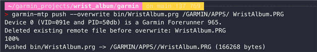

Try this cli. Garmin file transfers without drag-and-drop.
I built garmin-mtp: a small CLI for importing/exporting files from Garmin watches over MTP.
Pull CIQ logs, browse storage, push FIT files, and automate the workflow from terminal or Codex/Claude Code.
https://github.com/Likenttt/garmin-mtp-cli
