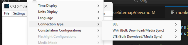

While implementing Wi-Fi support for web requests in my app, I also considered adding LTE support. From a technical perspective, this appears relatively straightforward, since the communication model is similar to Bluetooth. It seems that only additional handling of connectionInfo[:lte] would be required, plus in my case some work on the visual connectivity indicators.
However, I am unsure whether the effort is justified. As far as I can tell, Garmin has released only two LTE-enabled devices: the vívoactive 3 LTE and the Forerunner 945 LTE. Of these, only the Forerunner 945 LTE is capable of running my app.
Although the newer Fenix 8 Pro includes LTE-related features, it does not appear to provide general IP-based connectivity for CIQ apps.
So this is partly speculative, but I would be very interested in your perspective. Why did Garmin discontinue LTE after those two devices? Do you think LTE might return in future models with broader support for third-party apps?
I am also curious about the technical design decisions. With Wi-Fi, the emphasis seems to be on battery conservation through a dedicated sync mode. In contrast, LTE appears to have been designed as an always-on connection. What was the reasoning behind that approach?

    It is relatively simple in the sense that it does not involve a high data volume. There are users who would appreciate being able to use the app without having their phone with them. The main enabler for that would be Wi-Fi, which is a viable option since the app focuses on smart home control and is primarily used around the home, although there are use cases for remote access as well.
    That said, my question about whether it is justified was more about whether LTE app connectivity is something Garmin plans to make available again in future models.

    It does. As I mentioned, there are use cases for running my app outside the house, for example for remote control or checking the status of things at home.
    A very typical scenario is opening garage doors or entrance gates via the watch or cycling computer, often from areas where there is no reliable Wi-Fi connection. In most situations people will have their phone with them, but some do not. So if LTE is available on the device, it makes sense to offer that option.

  • See this thread.  The only Garmin device that can access the LTE is the VA3MLTE.  None of the newer devices expose the LTE to CIQ apps.  So there is no reason to support LTE.
