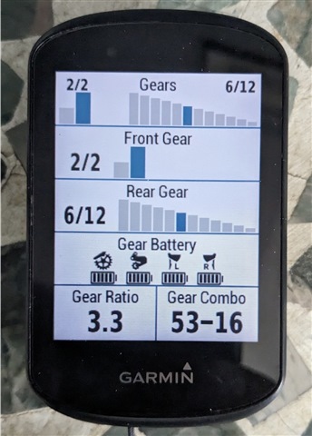

    An electric shift system with front and rear derailleurs is connected to the Garmin device as a single sensor. The battery data can be read on the device under Sensors - Gear - Info and can be set as native datafield:
    This data can also be read from a CIQ data field via Toybox.AntPlus.Device.
    You’ll get 4 battery components in an array that cannot be clearly assigned to front and rear or left and right.

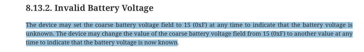

  • This is a good post but I think you're missing something with the voltage level.
    As per the ANT+ shifting profile:

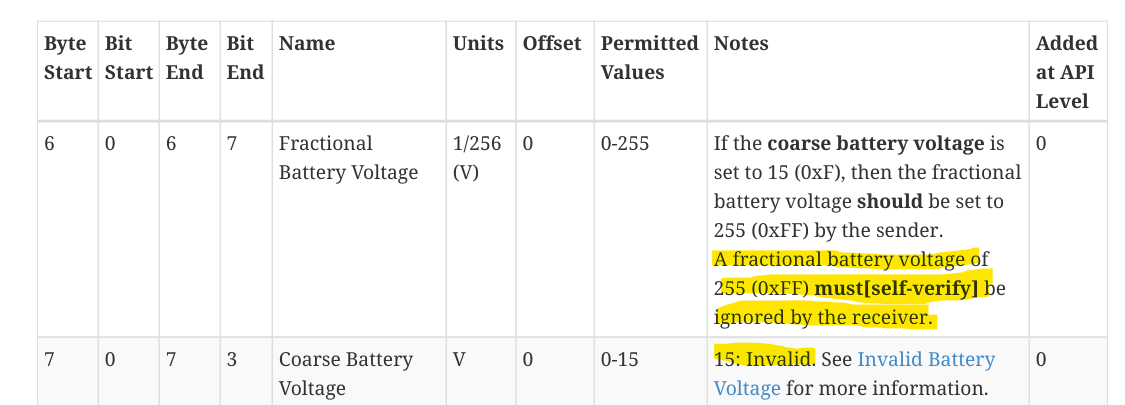

    - The "coarse voltage level" (byte 7, bits 0-3) ranges from 0-15, but 15 means invalid (battery voltage unknown)
    - The fractional voltage level (byte 6) ranges from 0-255, but 255 is an invalid value which must be ignored by the receiver (255 should be set when the coarse voltage level is 15.)

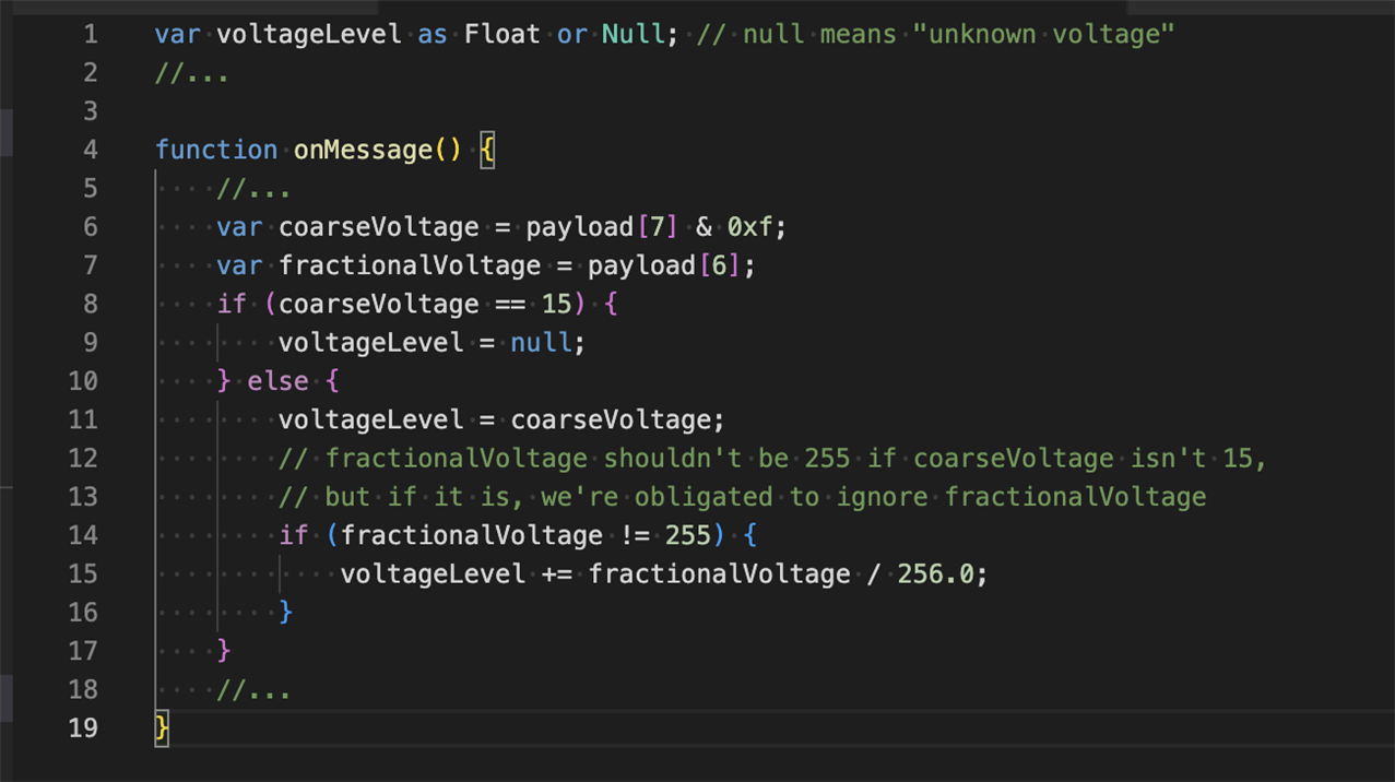

    An implementation for determining the voltage level that covers all the bases would look more like this:

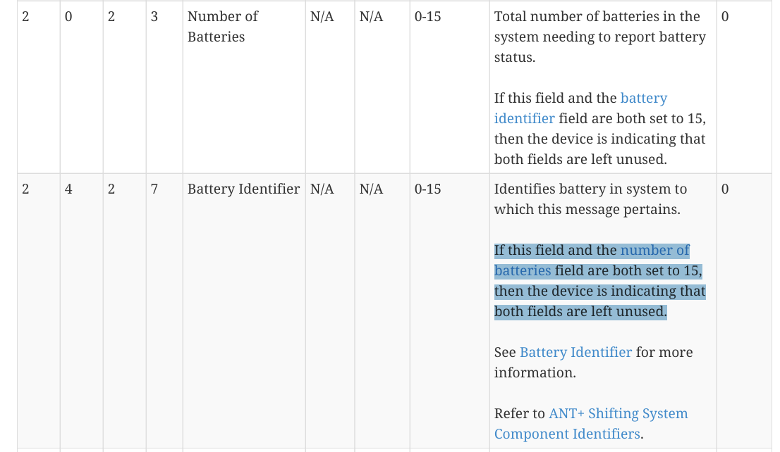

    - Number of batteries is byte 2, bits 0-3. (Range: 0-15)
    - Battery Identifier is byte 2, bits 4-7. (Range: 0-15)
    If both the number of batteries field and the battery identifier field are 15, then it means both fields are unused.

    I said that there are 3 specific edge cases called out in the specification [*] which relate to the code you posted:
    - coarse voltage = 15, which means voltage unknown
    - fractional voltage = 255, which should be ignored
    - number of batteries and battery id (component in your code) both equal to 15, which means they should be ignored

    It's pretty obvious from looking at the code I posted that if coarseVoltage is not 15 and fractionalVoltage is not 255, my code does the same thing as yours.
    It's simply a matter of reading the specification and writing code that adheres to it. In this case it's not even very hard to so (assuming you can access the specification **), it just requires you to care about writing code that works as well as possible.

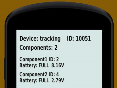

  • To return to the actual question of this thread:
    It is actually quite easy to find the type of components in a connected ANT+ electrical shifting sensor  – I just overlooked it:
    Class: Toybox.AntPlus.Device
    A rear only SRAM shift system:
