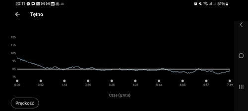

    3. When I look at the HR rate during my sessions it just stays the same or at the similiar level. Here is an example:
    For some reason session started at >95bpm level (my resting hr is somewhere around 60bpm) but then session started after 60sec and I was looking at the hr displayed by watch which was not going up so after couple of minutes I did pushed myself harder, felt my hr going up and as you can see the reading even went below the average line.

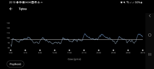

    Then I got pissed off so I restarted the session and here is HR for subsequet 38mins:

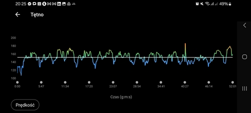

    Here is a HR from default tennis app which I recorded recently:
    I'm not an expert and maybe 100bpm is more accurate (doubt it) but if so why default tennis app shows 170-180?...
