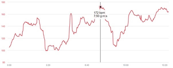

In general I recently noticed lower HR values coming from Fenix7 + graph looked like the sampling rate is low (1/couple of seconds). Tooday I investigated this issue:
1. I started my tooday workout using default Tennis  activity (Fenix7, CIQ 5.0.0, FW16.22) and hearrt rate was looking fine (first picture in comments):
