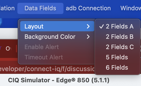

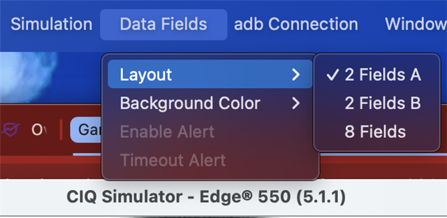

Why are two new Edge devices restricting the screen layouts for datafields?
There isn't even a full screen (1 Field) option as there has been on every Edge device up until now
I have the same issue and my simulator is not working properly when I want to trigger the app settings I only see a white screen. With all older devices, even the fenix8 Pro it is working fine... Is this a bug in the code or in the simulation of these two new devices?
I mean it should be obvious that this is a bug in the simulator. NO WAY Garmin doesn't allow full screen in the real device.
It could be a bug in the sim device config [simulator.json] / device reference [which both show the same thing- I assume they are generated from the same source]

It's not exactly the same thing, but a couple of years ago, a Venu Sq update broke the *detection* of a 1-field [fullscreen] layout for CIQ data fields. What I think happened is that a lot of these fields will detect a 1-field layout by assuming that if data field Dc size is exactly the same as the screen size, it's a 1-field layout, and if the size is different, it's not a 1-field layout. In this update, Garmin probably made the 1-field layout Dc slightly smaller than screen size, so a lot of fields started assuming they were in multiple field layouts and rendering incorrectly. After people complained, Garmin reverted the change.
Maybe the easiest thing would be to post a bug report in the CIQ bug reports forum?
