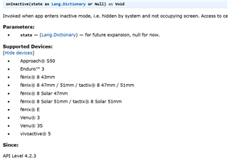

and in Toybox.Application.AppBase.onInactive (API Level 4.2.3, only on some new devices, like fenix8, venu3):
"Invoked when app enters inactive mode, i.e. hidden by system and not occupying screen. Access to certain system resources will be limited, such as GPS, ANT, Alerts (Vibs tones, flashlight)."

  • maybe it's a documentation bug, that they forgot to add some devices to the list of devices?
    idk, if you search ConnectIQ\Devices\*.api.debug.xml for symbol="onInactive", you get a list of devices which matches the docs.
    So if the docs are wrong, so is the debug info. (I think a lot of this stuff is genned from the same sources, fwiw, especially the type-check info.)
    My current guess is that Fenix 7 does have a task switcher (I mean this part is indisputable [*]), and it does affect the conditions for termination of CIQ apps, but it doesn't support the fancy new app lifecycle in Connect IQ.
    [*] the "recent apps" feature is right in the manual, and users talk about it all the time. It's also clearly not present in FR955 (nor any other pre-FR570/970 Forerunner, afaik)
