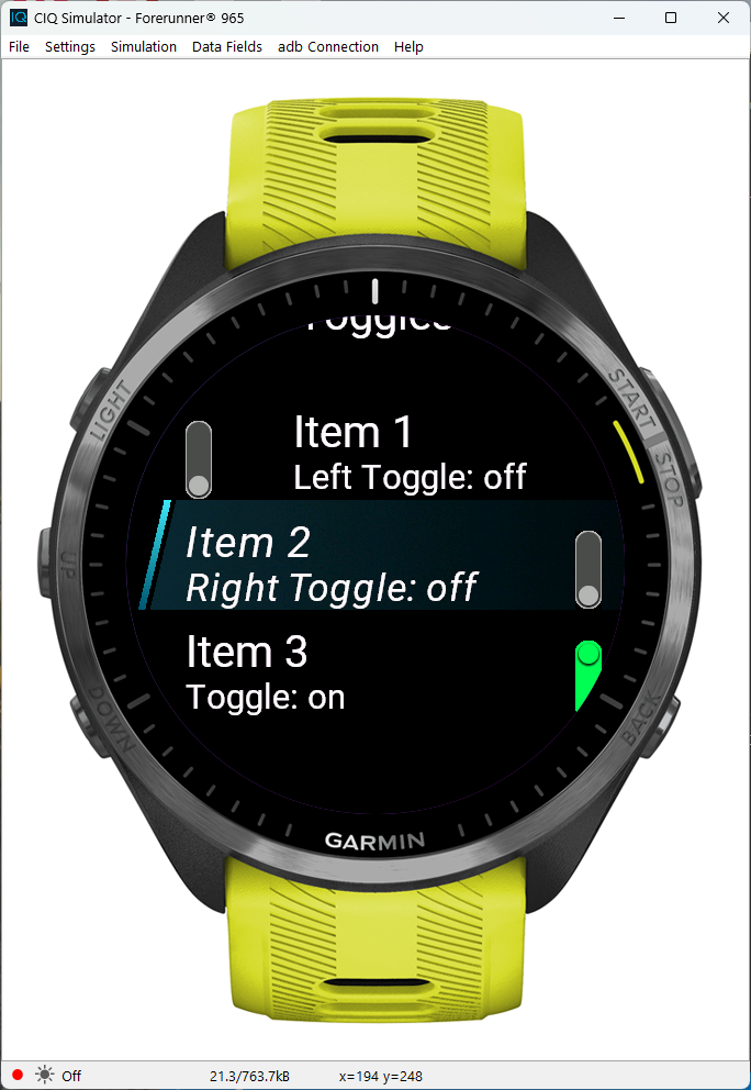

    That kinda depends on the device tbh. Older MIP devices (like FR935/FR945) will simply show the currently focused menu item in the center of the screen with no other hints, as you said. Newer MIP devices (FR955) will show a vertical line to the left of the currently focused item.
    AMOLED devices like FR965 will highlight the item with a gradient. e.g.

    I guess my point was more that at least on modern Garmin devices, it's easier for users to tell which menu item is focused (either due to vertical line or gradient highlight), compared to the really old devices where it literally just was a matter of which item is in the middle, as you said. Garmin actually has improved its UI quite a bit over the years, to its credit.
