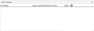

  • -How does the ant stick seem to be working for you in the sim?  I've not used mine in a while, but right now I can see a HRM, but not a Tempe...  Do you see the dog tracker (I don't have one) ?
    for something like this, I can see where debugging in the sim would be really helpful.

  • In the sim, with the ANT stick, the image I posted was from Settings>Manage ANT+ Sensors.
