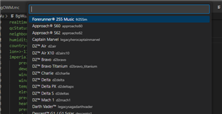

It asks me every time I do a run. In the screen shot I posted you'll see the 255 at the top, as that's the last target I had used. To select the app to run, I use this:
