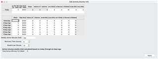

I notice each time the simulator resets its settings changed before when starting. e.g. activitity info settings.
If I want to use the current settings, I just don't close the sim and do a new "run". For some things, you may want to use "File>Kill App" in the sim, or for widgets make sure you close them with the back button.
