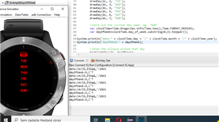

Hi, how do I make sure that the current day of the week is displayed in an ellipse?
Has anyone handled something like this?
Thank you.

    I don't know how to draw all the days of the week on my face and I also don't know how to draw the dc.draw object so that it is everywhere it should be.
  • Will all the days fit on the screen at once? Is that what you want?
    If so, you have code that draws one. To draw another, take one day off the date and draw the same (without the ellipse) with different x and y coordinates. Keep going until you get to the day you consider the first day of the week. Do the same in the other direction as well until you get to the last day.
    I'm not sure what you mean by 'everywhere it should be'. Do you mean to draw all the days. To do that keep adding 20 pixels (or whatever you like) to the y coordinate as you draw.

    • Yes i want to show on watchFace all days it means: MON, TUE, WED, THU, FRI, SAT, SAN. I want to have the current day in an ellipse. that's what I'm trying to do

    it would only help me if I knew how to draw all the days of the week and how to position the ellipse so that it scrolls across the display as the days of the week. only this is what I would need from you and it will be enough for me. please sample code.

    But yes, basically I thought that all days of the week should be displayed on watchFace and that only the ellipse would move according to the day. I don't know much about this, because I can't display all the days and position the ellipse so that it is different (x, y) every day. I would be grateful for your help and I could go on.

  • You caught me on holiday.  I have attached a working example watchface.https://www.dropbox.com/s/gm7744altroc5gb/ExampleDaysOfWeek.zip?dl=0
    If you run this, it will draw all the days of the week down the screen and highlight the current day. All the code is annotated.
    It is based on the default watchface example that loads when you create a new project. The layout.xml and drawables are still there but not required. They can be deleted
