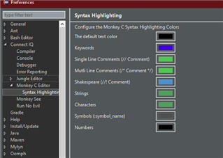

4. How do I change the text color in eclipse for Monkey C developing?
Seriously. This is an issue. I use eclipse in dark mode, yet, when opening my first sample project, the primary text color was BLACK. Meaning, I can barely see anything. First of all, it's hard for me to understand how this even can happen, given, that the text color should be dictated by eclipse's theme setting, secondly, I am appearantly to stupid to change it. My solution was to temporarily simply use eclipse in light mode until I am finished with my project, but that just can't be a long-term solution.
    I agree that this is terrible, and as matter of fact, is one of the many reasons I dislike using Eclipse for CIQ development. IMO, it also highlights the lack of attention to detail that is sometimes seen with CIQ (from Garmin as a whole, not any individual employee).
    To change Monkey C colors, select Windows > Preferences > Connect IQ > Monkey C Editor > Syntax Highlighting.
