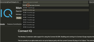

I have been waiting for half month
In the latest release, an error like 'failed to parse monkeyC IR' will be thrown when using 4.0.3 SDK to compile my project.
My app supports app like fr55, included only high version sdk, in which case I have to use a high version. But the error is always there. Therefore, I use vscode to write code and eclipse to compile and simulate. Eclipse is so cranky or clunky. I want to get rid of it soon
