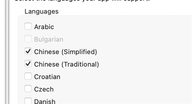

I've had error form era
Forerunner® 245: 5.60
Languages: cht
There is no cht in manifest. Is it zht? Should I create resources *.cht?

繁体中文语言代码是zht
<iq:language>zhs</iq:language>
<iq:language>zht</iq:language>
You don't need to change anything. Internally, the compiler and runtime system use cht and chs for Traditional and Simplified Chinese language codes. We map zht to cht and zhs to chs internally.

I don't think so. Looking at the readme in the CIQ SDK directory, it looks like CIQ used to use cht/chs, but now uses zht/zhs (apparently, both are allowed). It's too bad that "cht" appears in the ERA report, though, as it seems to cause potential for confusion.
The OP was concerned that we were using cht/chs in the ERA reports, asked if he needed to change anything, and then showed that he has zht/zhs in his project manifest. I'm fairly confident that I'm correct in saying that he does not need to do anything.
