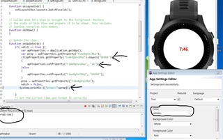

  • I tried this:
    <properties>
    <property id="timeBgValBkp" type="string">11111</property>
    <property id="BackgroundColor" type="number">0x000000</property>
    <property id="ForegroundColor" type="number">0xFF0000</property>
    <property id="UseMilitaryFormat" type="boolean">false</property>
    </properties>
    <settings>
    <setting propertyKey="@Properties.timeBgValBkp" title="@Strings.BCTitle">
    <settingConfig type="alphaNumeric" >
    </settingConfig>
    </setting>
    <setting propertyKey="@Properties.BackgroundColor" title="@Strings.BackgroundColorTitle">
    <settingConfig type="list">
    <listEntry value="0x000000">@Strings.ColorBlack</listEntry>
    <listEntry value="0x555555">@Strings.ColorDarkGray</listEntry>
    <listEntry value="0xAAAAAA">@Strings.ColorLightGray</listEntry>
    <listEntry value="0xFFFFFF">@Strings.ColorWhite</listEntry>
    </settingConfig>
    </setting>
    <string id="AppName">Test</string>
    <string id="BCTitle">Color</string>
    <string id="BackgroundColorTitle">Background Color</string>
    <string id="ForegroundColorTitle">Foreground Color</string>
    <string id="MilitaryFormatTitle">Military Format for 24 Hour Time</string>
    <string id="ColorBlack">Black</string>
    <string id="ColorDarkGray">Dark Gray</string>
    <string id="ColorLightGray">Light Gray</string>
    <string id="ColorWhite">White</string>
    <string id="ColorBlue">Blue</string>
    <string id="ColorRed">Red</string>
    </strings>
    function onUpdate(dc) {
    if( settingsChanged == true ){
    var apProperties = Application.getApp();
    var prop = apProperties.getProperty("timeBgValBkp");
    if(apProperties.getProperty("timeBgValBkp").equals("bbbbb"))
    apProperties.setProperty("timeBgValBkp", "aa");
    else
    apProperties.setProperty("timeBgValBkp", "bbbbb");
    settingsChanged = false;
    System.println (["prop>>"+prop]);
    and my settings in the Eclipse and App Settings Editor don't change. I use Windows7 and android.
