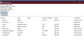

  • I have a long list of settings and large custom fonts (I use filters, I tried to save every byte possible) . So the problem is probably not my code but the memory.
    Please do you have any idea how much memory I can use? I supposed that the settings values are separate because they are physically "in the phone". Am I wrong?

    You can see your current  and available memory on the status bar the bottom of the sim:
    You can also see peak memory and other stats with File > View Memory:
