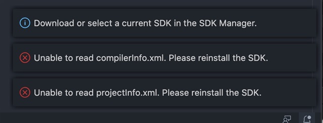

  • Thanks Kyle. Unfortunatley, still not working for me..  This is what I did:
    - Update the extension in VSCode to 0.1.4 and restart VSCode
    - Copy the connectiq-sdk-mac-3.2.3-2020-10-13-c14e609bd folder from its default location to a new folder containing no spaces.
    - Then, update the current-sdk.cfg file in the original location to refer to the new location.
    - As soon as I go to Verify configuration.  I get the attached
    - So I unset and reset the current SDK but I can see in the current-sdk.cfg file that it reverts back to the original location ("Application Support").  If I change the CFG file again I keep getting the above messages.
    The App BUILD process still completes, but a Run App still presents a blank simulator window, but this time a message appears in VSCode saying "Unable to connect to simulator.".
    Unfortunately, I cannot choose to install the SDK Manager in any other path - it seems to default using "Application Support" on macos.
  • When you edit current-sdk.cfg, make sure there isn't trailing whitespace. I just edited this file with vim and it was tacking a \n at the end. If I use TextEdit it doesn't do this. Is it possible this is the issue?
    Thanks for using the extension in its alpha state and helping us work out bugs. I just fixed this trailing whitespace issue so it'll be in our next release.
  • Thanks Kyle.  Looks like that might have been the issue.  I edited the current-sdk.cfg file using notepad++ in a windows VM and turned on showing control characters.  None were visible when I saved it.  Now My App runs, though I did have to "run twice" the first time (but only the first time).
