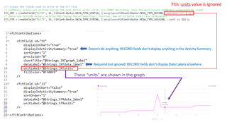

The :units element in createField seems to be totally ignored. Or, am I missing something?
  • I think you're right. And if we're both right, then maybe the documentation of createField should remove the recommendation to translate :units to the current language, and instead keep it easy with a constant (i.e English) value, and thus prevent bugs like what I encountered here: https://forums.garmin.com/developer/connect-iq/i/bug-reports/feature-request-add-maxlength-maxsize-attributes-to-string-resources-and-fail-at-compilation-if-a-string-is-too-long

    2) The OP is missing the larger point that *all* of the options for createField which are *also* specified in the fitContributions resource XML are ignored...by Connect, and to note that these are all strings.
    i.e. It's not just :units, it's also the 1st arg to createField().
    It might be helpful to...
    2a) ...note that the strings in createField() still written to the FIT file
    2b) ...consider that there is actually a good reason for Connect to use the fitContributions XML strings, rather than the createField() strings: the strings referenced in fitContributions XML can be properly localized, while the strings specified in createField cannot. Sure, you can follow the docs' recommendation to translate the strings in createField to the current language, but each of them can only ever be in one language. In contrast, the strings it fitContribution XML can be specified in multiple languages.
    2c) ...consider that any 3rd party sites which display CIQ developer fields don't have access to fitContributions XML and would therefore have to look at the strings specified in createField() after all

    - it's not just :units, it's all the strings specified in createField() which are also in fitContributions XML
    -- i.e. both the 1st arg to createField() (the field name) and the units are also in fitContributions XML, so by the OP's logic, they are both "ignored"
    - it's not a bug; the actual reason is that fit contributor strings can be specified with multiple languages in the XML, while there's only one copy of the strings in createField
    - 3rd-party sites would still need to reference :units (and other strings in fitContributions XML), so it's not like those fields are completely useless
