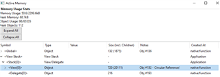

  • Also, I saw this, which I think is a bug, when I pressed Ctrl+M:
    Leastways, I haven't encountered any circular reference errors anywhere and this was with a mature project that has been live for some time.
  • What type of app, and which target?  I looked at a number of mine and don't see it.
    I posted some code yesterday on sharing code between a background service and a main app, and in the Wcomm class, you'll notice I set callback=null after involking the call back.  Without this, you could see a circular reference.
    What's changed in your app?  If you switch back to 3.1.9, do you see it there too? (the same plugin works with both 3.1.9 and 3.2.1)
