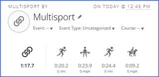

  • Yes, but you need a watch supporting the Multisport feature. You can then use the option Change sport to add legs of different (or same) sports to the common multisport activity.

  • Which watch do you have? If it's the 645 as the OP stated, it won't be possible. If you have a newer multisport-capable watch, you can set a hot key to "Change Sport." Just start any activity, like run, then when you want to switch to a different sport, press the hot key combo you set up. When you stop/save the activity it will show up on Garmin Connect as MULTISPORT with all the different sports listed in one activity.

  • Multisport is not only for triathlons. It is usefull for any combimation of sports, exactly as you asked in the OP. However, it is very unlikely Garmin would retrofit the FR645 with this feature
