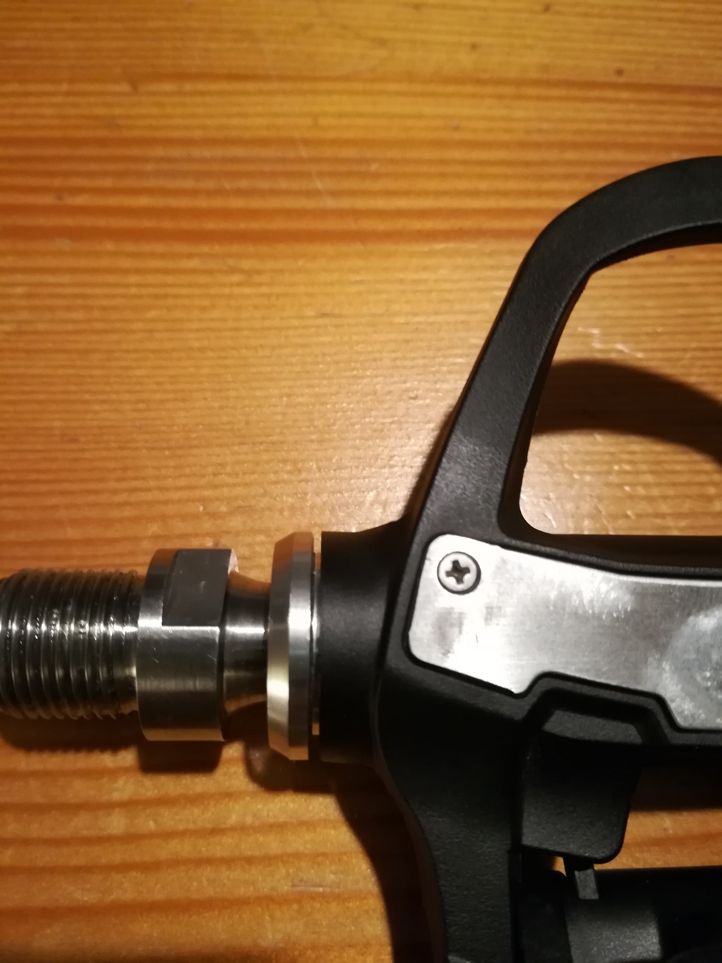

    Hello,
    I have received my Vector 3 set today and took them out for a ride. In order to have a reference for future workouts I went for a 5 minutes test at maximum intensity. The pedals worked fine on the hour before the test and during the test itself. After a few minutes of easy spin I started a new set when I got the error message: "right sensor missing". I tried to turn off my edge 520 and restart it but the issue remained.
    Back at home I had a closer look at the pedals, the right one in particular. I noticed two things:
    1) There is a small gap between the metal and plastic part of the body as I will try to illustrate with a photo. The left pedal does not have the same gap.
    2) The right pedal is especially hard to turn by hand, considerably more than the left one. It actually requires me to grab the spindle with a cloth to ensure I have enough grip. On the other hand the left pedal turns freely enough that it will regain a vertical position within a few seconds if I unclip.
    The battery is not an issue as I still get the LED to turn on when I move that particular pedal.
    Hopefully someone can suggest the best course of action for me.
    Thank you.ciq.forums.garmin.com/.../1306374.jpg
  • Former Member
    0 Former Member over 7 years ago
    HugoB - Please contact Garmin Customer Support. They will need to replace the right pedal body for you.It looks like the right pedal body was not assembled correctly and did not have enough loctite applied.
    Without the specialized tool you will not be able to remove the pedal body from the cartridge to apply some loctite without causing some damage. You might have success with the Park Tool pin spanner, but as the system is new I would recommend just getting the pedal body replaced.
    As the pedal body undoes it will push the PCB away from the connector pins and cause the spindle to lose electrical power.
