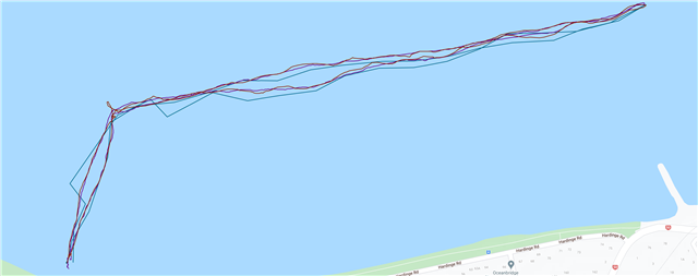

  • Garmin watches, as you quite correctly point out, guesstimate he track from some magic algorithms that they've developed over a number of years since (if memory serves me correctly the FR310XT). Back in the days of the 310XT the tracks were initially pretty garbage but got progressively better clearly identify the path taken. The path the 935 presents is indeed well-smoothed but that is not the same as saying it does not show where you've gone. My regular swim is down a measured buoy line of 2000m, when extended as shown this brings it up to 2500m. For reference the difference between the watches used this morning was around 30m. Newer watches have a much less smoothed track and show similar tracks when compared to a watch in a float bag.
    For comparison. this from a swim this morning with a 935 and F6, one on each wrist, clearly illustrate this:

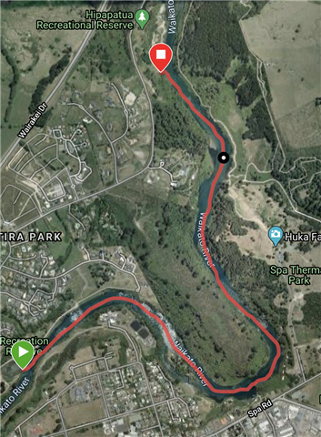

    More examples:
    Since this was a 3.3km river swim, it's hard too argue that the track recorded is not the track swum:
    I am aware that the screenshots I have posted are mostly not from a 935 but that's because I rarely swim with the 935 except to do a comparison track - see my earlier post with that track.
    So, in short, if you have a reasonable swim stroke, the watch can give you a reasonable indication of where you've been and the distance covered when worn on your wrist. If your swim stroke is not conducive to recording a track, or you want a good swim track then by all means put your watch in a float bag or under your swim hat. That's something even Garmin suggest you do -
