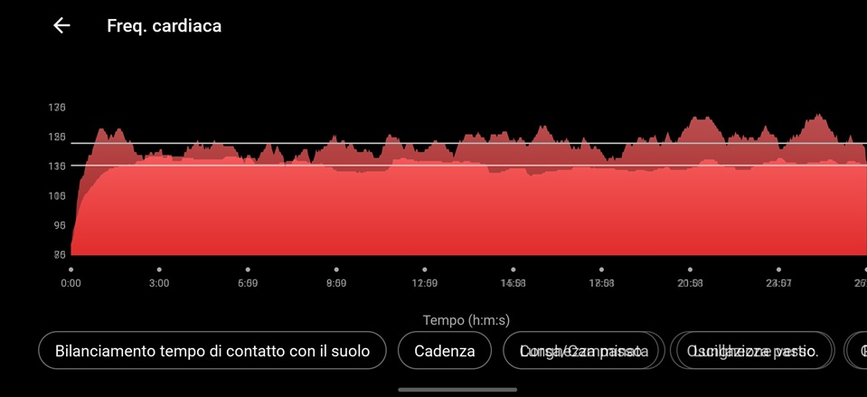

  • I experience also very bad OHR behaviour, which were not present in the past; allthough I didn't notice it.
    Last weekend I cycled again for the first time this season.
    In red I marked all area's which had a wrong HR.
    Optical measurement, watch was tight enough arond the wrist and in the right position.

  • In dark red the heart rate from polar h10 and in red from ohr. We're not quite there. Same comparison done in June 2022 and it was almost perfect.
