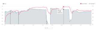

  • sometimes it's pretty consistent
    sometimes it's just wrong until it either suddenly gets it right, or I've noticed it's wrong and move the watch 180 degrees to under my wrist to try and get it back on track
    this triathlon example is bad, since it's gone from pretty accurate to over reading for the last 1/3 of the activity - so it's lost tracking, rather than finding the correct 'beat' after a while

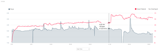

    and this one from 2022 shows it getting it wrong for the first few minutes, then the rest looks fine - so older firmware also shows errors, but perhaps less often

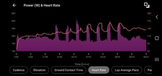

  • Here I think is the problem you describe, in a 255 running firmware 19.18. I was troubleshooting HR tracking issues by restricting the watch to optical (wrist) HR while tracking a bluetooth chest strap to Polar Beat on the phone. This is a workout with 7 intervals, and as you can see, the watch misses the HR (but not the power) of the first three intervals while the chest strap gets them fine.
