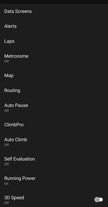

Turn off 3d distance.

These stupid questions are right questions. Just read a bit how GPS systems work, how reliable they are and why weather might matter a lot, your location (high buildings) trees) matter a lot and why you shall turn off that crappy setting of 3d speed, I really don't understand why it is on by default on new devices.

I opened it to try a different combination setting in a new run because I had some experiments with 3D Speed off. I normally keep it off.

Also, while the distance run with 3D speed on yesterday was 7.64K, today I turned it off and the distance run was 7.28. The correct distance is 7.0K
