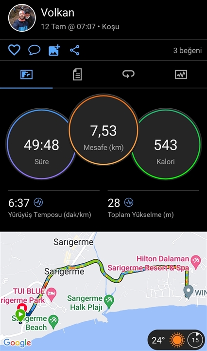

Hi all,
Same route, same road, same distance.
The route length is 7K.
But what I notice in running is that the GPS decreases the distance as I speed up and increases it as I slow down.
What is your opinion?
