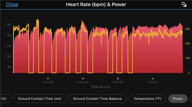

    Blake, I’ve been providing all of the data points above to Garmin support since November and the only responses I’ve received about this range from “huh”, “um”, “oh well”, and “only you and two others have this issue”.
    I’m seeing these 3.5 minute drop outs on absolutely every run I do outside and never once has it occurred inside.  Recently I’ve tried using the Run profile with GPS turned off and I’ve tried running outside but with the Treadmill activity profile (since that’s what I use inside when the drops never happen). You can look at my hour+ runs and see it happen over and over and over and over and over (10 times over a two hour run yesterday).  When the drops occur all ant+ devices are lost completely.  Heart rate flat lines on the last recorded signal briefly, drops off a cliff, and then slowly recovers while being picked up from the built in optical hrm and eventually reconnects with all of the typical buzzing and alerts associated with that.  Everything else goes to 0 until reconnecting.
    I’m using an HRM-Run, Stryd, and Tempe with my 945 on v4.00.  I’ve never installed any of the beta versions.  Replacing batteries multiple times does nothing.  I’ve tried both of my Stryds (newer “wind” version and the one before that) and the same thing happens.

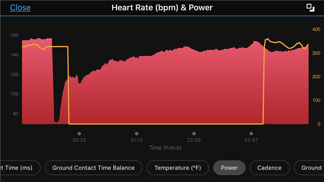

  • Former Member
    0 Former Member over 5 years ago in reply to Former Member
    Here’s one of the typical drops zoomed in.  You can see how it keeps recording the same number before giving up and going to zero and also how the optical hrm starts up until ant+ comes back.
