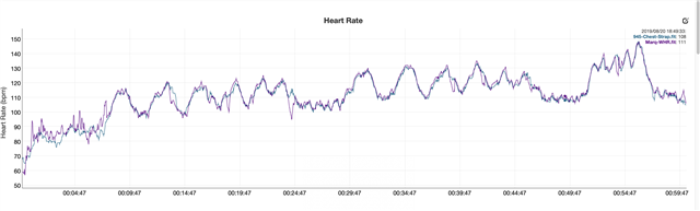

    WHR has a way to go to get to the same level of reliability and accuracy that I achieve from my chest strap. And I actually believe I am one of those for whom WHR works reasonably well...when it does work. I really can't fault it when I get results like this for an indoor cycling activity:
    Just wish it was consistent.
